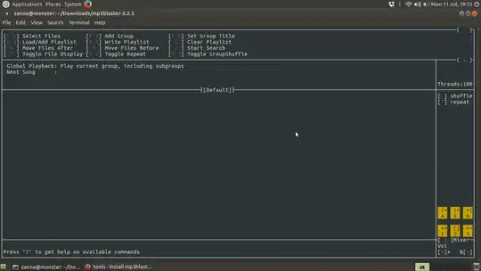

Now you can launch && enjoy with
mp3blaster
