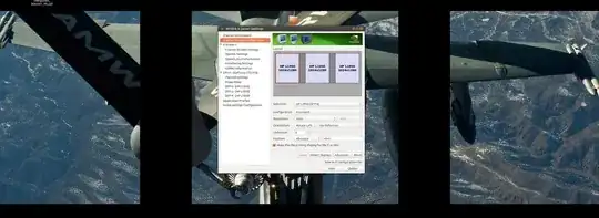

Every time I reboot my screens are like this, with a space in between them. My xorg.conf file does not get overwritten each time since the content is identical from one boot to the other (xorg.conf identical to xorg.conf.backup). So changing the file attribute to +i does not change a thing. Modifying grub file with nogpumanager either. If I log out and log in, my screen config is still OK. Problem occurs only when I reboot.
# nvidia-settings: X configuration file generated by nvidia-settings
# nvidia-settings:  version 331.20
The correct line is there:
Option "metamodes" "DVI-I-1: nvidia-auto-select +0+0 {rotation=left}, DP-1: nvidia-auto-select +1024+0 {rotation=left}, DVI-D-0: nvidia-auto-select +2048+0 {rotation=left}"
Thanks.

The fact that your screen setup is not remembered on restart (re- login) is most likely the result of a minor incompatibility between your screen(s) and the graphics driver. To work around:
If I made no typo or mistake, the command:
xrandr --output DVI-I-1 --pos 0x0 --rotation left --output DP-1 --pos 1024x0 --rotation left --output DVI-D-0 --pos 2048x0 --rotation left
...should make your screen setup
How to add to startup applications
  1. Copy the code below into an empty file, save it as setup_screens.sh, and make it executable
    #!/bin/bash
    xrandr --output DVI-I-1 --pos 0x0 --rotation left \
    --output DP-1 --pos 1024x0 --rotation left \
  2. Test-run the script by the command:
    /path/to/setup_screens.sh
  3. If all works fine, add to Startup Applications: Dash > Startup Applications > Add. Add the command:
    /bin/bash -c "sleep 15 && /path/to/setup_screens.sh"
Explanation
The explanation on why and how can be found on this answer. The sleep 15 is to make sure the desktop is "ready" before the setup is done.
