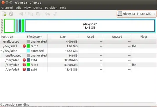

But then I analysed I didn't really needed any of these to be mounted, I only needed them to be resized, so I installed Gparted tool to do this and this is what i could see:
my gparted looks
The fat32, fat16 and ext4 partitions appear with a red icon logo indicating some kind of problem. When I right click on information for ext4 partition it says:
e2label: No such file or directory while trying to open /dev/sda7
Couldn't find valid filesystem superblock.
tune2fs 1.42.9 (4-Feb-2014)
tune2fs: No such file or directory while trying to open /dev/sda7
dumpe2fs 1.42.9 (4-Feb-2014)
dumpe2fs: No such file or directory while trying to open /dev/sda7
Unable to read the contents of this file system!
Because of this some operations may be unavailable.
The cause might be a missing software package.
The following list of software packages is required for ext4 file system support:  e2fsprogs v1.41+.
I checked my sdcard in Windows with chkdsk tool (as suggested in Warning image in Gparted) and no problem was found. I also checked and there are no software packages missing
I don't know what is wrong but the fact that I can't mount the device and that gparted is giving me so many errors tells me that something is wrong.
My questions are:
  1. Is there any other safe way to shrink the Pi SD card image without losing the data?
  2. Is there another proper way to load the micro SD card into the Ubuntu VM (connecting it as an USB device is not working either)?
  3. Why am I seeing 2 devices instead of one with fdisk -l?
  4. How do I get gparted to work?
