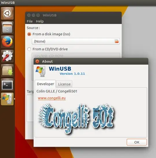

A screenshot from my Xenial system following successful installation:
