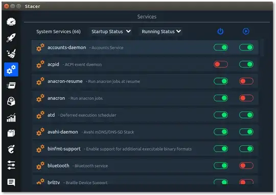

There is a good GUI application called Stacer where you can manage all the services.
Check its Github link Stacer Github
Also check Web for more info
