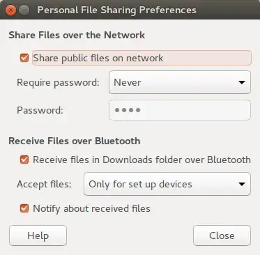

Personal File Sharing Preferences for the folder “Public” on box3 are set to share public files on network and “Never” require a password.
Screenshot: Personal File Sharing Preferences

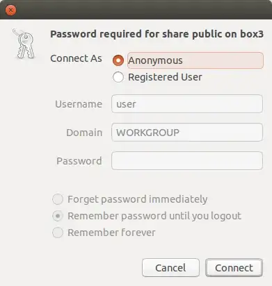

When accessing the public folder from box2 a password is required for share public on box3.
Screenshot: Password required for share public on box3
Connection attempt as Anonymous without a password fail.
Unable to access location Failed to mount Windows share: Permission denied
