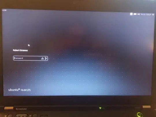

Before being presented with the actual login screen, I am presented with another additional login screen.
What is this second login screen?
Actual login screen:
Additional login screen:

Remove your .Xauthority.
mv .Xauthority .Xauthority_2016-07-03
sudo service lightdm restart
You could also try just changing it's ownership:
sudo chown user:user .Xauthority
...replacing user with your username.
