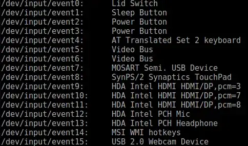

  1. Used the evtest command to scan all /dev/input/event*
This was the result:
  1. Enter device event number 5 (Video Bus)

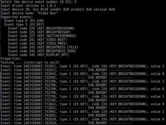

  2. Then waited till the screen brightness changed randomly again to see the output about the event. This was the output (a sample):
Every time the brightness increases or decreases randomly, the information about the new event is displayed in the terminal (after a couple of hours the output is really long).
So it seems like some events happen, I just don't know why.

You can try this: Brightness randomly up and down on MSI laptop
You can add the following to /usr/share/X11/xorg.conf.d/10-quirks.conf:
  Section "InputClass"
  Identifier "Spooky Ghosts"
  MatchProduct "Video Bus"
  Option "Ignore" "on"
  EndSection
This basically ignores messages from the Video Bus, which seems to be sending pseudo fn+up fn+down messages randomly.
Also to add on, the brightness changing correlates to CPU voltage changes. MSI laptops seem to have a weird mobo setup, and Ubuntu may misinterpret some of the messages sent by the BIOS as brightness up/down messages
Note that this fix is not permanent, and some OS updates may overwrite 10-quirks.conf. as it is used to fix hardware bugs such as these. But if you see your screen brightness changing again, you can simply redo this step.
