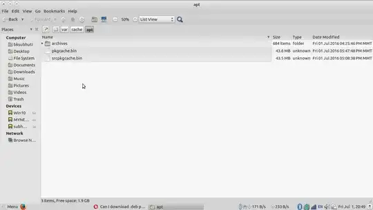

Find another system that has 12.04 and then install everything you want using synaptic or app store, (or terminal). Then copy all of the files you find in (root)/var/cache/apt and to your machine in the same directory (with root access). You still might need to have an updated cache, but all heavy downloading should be finished with this method. Do not copy the lock file.. and it won't let you anyways.
I usually type (you might type nautilus instead of caja for ubuntu) to launch a gui file manager with su privs. It is dangerous, but terminal can be more dangerous. Close it when you are done.
gksu caja
The next methodenter image description here
