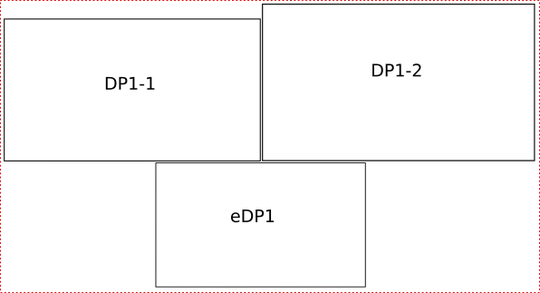

Seemingly "out of nowhere", my Dell e7440 running Ubuntu 16.04 with 2 external monitors displays only the login screen for external monitors, when I login it shows system error and external monitors will dark out.
Couldn't see the display options as well:
could not get screen information
PS: Everything works in guest session
What could be wrong with my setup?

Corrupted monitors.xml file
As mentioned in a comment, if your monitors darken on (only) one account, working on other(s), most likely your monitors.xml file is somehow corrupted. To fix, remove ~/.config/monitors.xml, immediately log out and back in.
