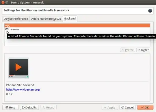

Memory usage in Amarok can be decreased by changing the phonon backend from gstreamer to phonon-backend-vlc. Run the following:
sudo apt-get install amarok phonon-backend-vlc
Then open Amarok and follow this trail:
Settings > Configure Amarok > Playback > Configure Phonon > Backend
And when you are there select vlc, as demonstrated in the screenshot below:
As you can see you now have the option of switching from one backend to the other; useful if you wish to generate some hard statistics of memory usage with the different backends....
