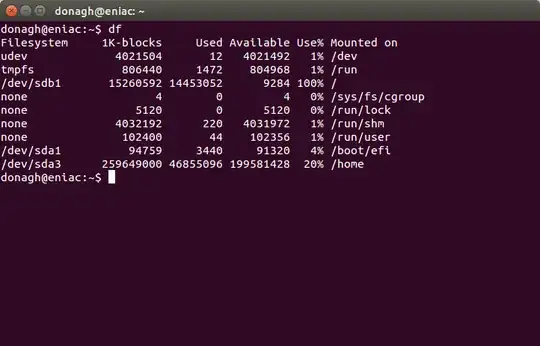

Not a duplicate of How to extend my root (/) partition?. That example the reporter can see his root partition. I cannot. I want to resize my root partition to make it bigger but when I run gparted the root partition does not appear. In the screenshot below my root is called /dev/sdb1 but that does not appear on gparted. The other ones do however. Also when I boot using a boot disc and type df then the root partition is called cow.
Can anyone help me to solve this please.
State of my partitions
Ok So this is my real problem. I cannot seem to allocate more space to my root partition because as @ByteCommander pointed out I need to select that partition from the top right but when I do that it is the only partition on the screen as you can see from my picture below. So how can I move space from one partition to the next if there is none available before or after it?
My root partition on its own which I cannot get any space allocated to as I have no partitions either before or after
