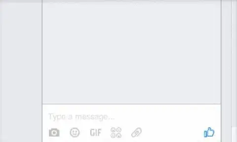

  • It only happens on some text areas, not all. Facebook's chat box has the problem, as seen below
screencast
During this screencast I only typed g a Enter and moved the mouse. I never used Backspace nor Delete nor clicked anything.
