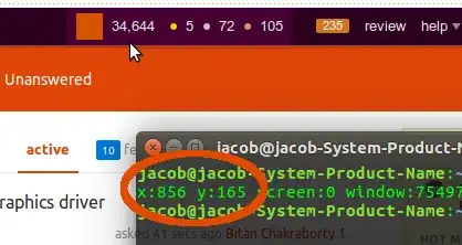

    • place the mouse on the button to be pressed (don't press)
    • press Ctrl+T to open a terminal
    • type the command xdotool getmouselocation
    • read the coordinates and set them in the head section of the script:
      xmouse = 856; ymouse = 165
