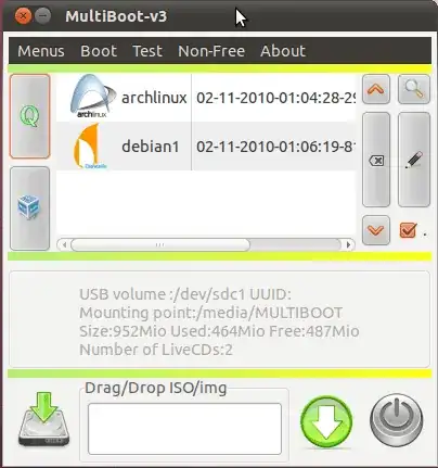

I use Multisystem. Run:
wget http://liveusb.info/multisystem/install-depot-multisystem.sh.tar.bz2
bunzip2 install-depot-multisystem.sh.tar.bz2
tar xf install-depot-multisystem.sh.tar
bash install-depot-multisystem.sh
to install it. Then open it and you will see this:
Select USB Multisystem
and select your USB. Then you will see this:
Add distorts Multisystem
Then just drag and drop the isos.
If this doesn't work, maybe use UUI in WINE. I haven't done this for ages, but give it a try.
