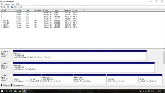

UPD: Looks like the bootloader and the uefi patrition are physically on that HDD: enter image description here
So it's impossible to boot without having it. How can I fix it?
I've found the answer. If it could come in handy to someone - the thing was to create EFI partition on the drive where the Windows was installed. It looks like after installing dual boot Ubuntu it moved that partition to the partition where GRUB and Ubuntu were installed and I had to bring it back home.
