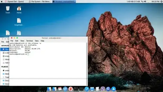

I thought to give kubuntu-desktop a try on my xubuntu. So i installed it. On reboot, a white line appears on my screen. I removed all kubuntu-desktop that i previously installed but the line still remains. Here is a screenshot. How do i remove it? enter image description here

"show shadow under dock windows" in compositor is all that i had to disable.
window manager tweaks > compositor > show shadow under dock windows
