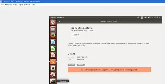

Problem is that after I download the google chrome for Debian/Ubuntu but when I click install, nothing happens.
Thanks in advance!
Here is my installation screen pic!

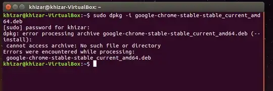

And when i try sudo dpkg -i google-chrome-stable_current_amd64.deb shows: enter image description here

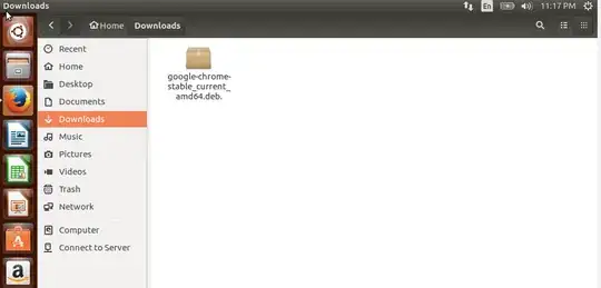

And Here is my downloads folder where chrome is present but Ubuntu doesn't detectenter image description here

Option 1: pure terminal
You were in your home directory (indicated with ~) in the terminal window. However, the file is located in ~/Downloads directory. So write sudo dpkg -i Downloads/goo and press Tab. It will complete the filename (if it’s not ambiguous – and it won’t be ambiguous in your almost empty Downloads directory).
Option 2: involving GUI interactions
Another option is to write sudo dpkg -i and drag the file from Nautilus into Terminal window. This should fill in the full path.
