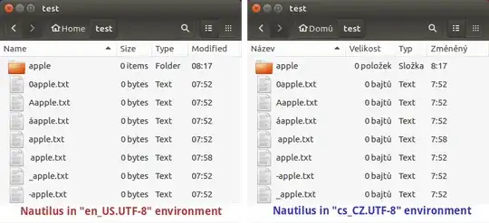

File sorting
How will Nautilus sort these files in different locale environment? Turns out that it is similar but slightly different. See the following screenshot for comparison.
Nautilus in English and Czech environment
Nautilus sorted files in English environment en_US.UTF-8 like this:
apple <-- directory
0apple.txt
Aapple.txt
áapple.txt
apple.txt <-- original file without prefix
 apple.txt
_apple.txt
-apple.txt
Nautilus sorted files in Czech environment cs_CZ.UTF-8 like this:
apple <-- directory
0apple.txt
Aapple.txt
áapple.txt
 apple.txt
-apple.txt
_apple.txt
In both locales, there is no change in order of directory and top 3 files when viewing as list in Nautilus. This already shows that no alphanumeric character can appear before 0apple.txt.
