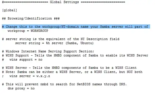

A screen shot of the global settings:

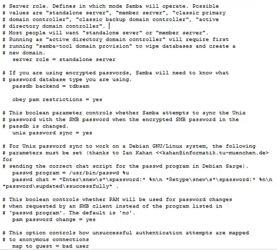

The authentication settings:
sudo passwd -a username and set your password for your given username, use it when Windows asks for the name and password.
