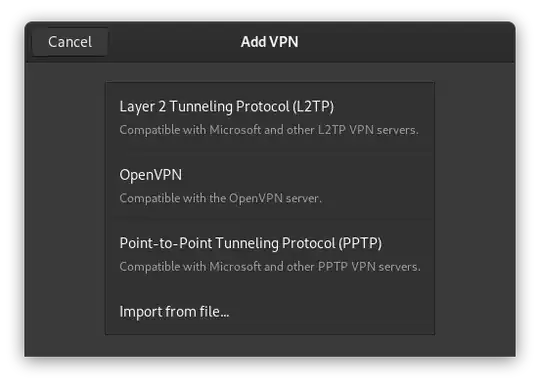

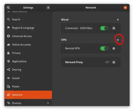

  4. Navigate to Settings > Network and click the + button next to VPN enter image description here
  5. Select "Layer 2 Tunneling Protocol (L2TP)" enter image description here

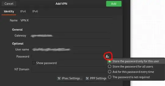

  6. Fill out the basic VPN information
    • Provide a descriptive name
    • Put the VPN endpoint in the Gateway field.
    • Put your assigned username the "User name" field. (Might be an email address)
    • Click the icon in the Password field and select your preference for how to supply the password. enter image description here

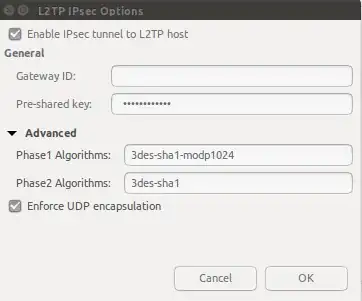

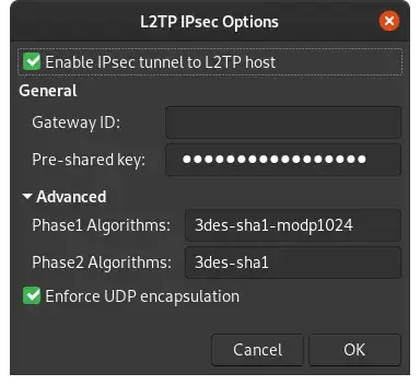

  7. Click IPSec Settings...
    • Click the box for "Enable IPsec tunnel to L2TP host"
    • Enter the shared secret into the Pre-shared key field.
    • Leave the Gateway ID field empty.
    • Expand the Advanced options area
    • Enter "3des-sha1-modp1024" into the Phase 1 Algorithms box.
    • Enter "3des-sha1" into the Phase 2 Algorithms box.
    • Leave the box checked for "Enforce UDP encapsulation". enter image description here

If you have a Meraki device you have to enter the Phase 1 and Phase 2 Algorithms:
go to "IPsec Settings..." on the "VPN" tab, drop down the "Advanced" area and enter these:
Phase1 Algorithms: 3des-sha1-modp1024 Phase2 Algorithms: 3des-sha1
