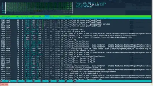

I've upgraded my laptop (Lenovo Z50-70) which has an i7 CPU and 8Gigs of Ram to Ubuntu 16.04 from 15.10. I've been installing updates consistently. I'm using ubuntu with Gnome desktop environment (GDM).
Lately I've been experiencing a weird problem, my CPU (including all 4 cores) are 100% used by some processes like gnome-software(Gnome software) and fwupd(Firmware update daemon). This makes my work goes down. If i even kill those processes, they are starting back again.
Is there a solution for these processes to not utilize 100% of my CPU. And I don't want answers saying use the cpulimit utility to provision the amount of CPU for those processes. I find this a core problem in Ubuntu, i'm expecting real solutions for the problem.
What I've tried so far is, Removing those PPA's i've added except the official PPA's for checking updates. That didn't work out! Attached a screenshot of htop screen of these processes.
Cpu 100% usage of gnome-software and fwupd

Had a similar issue.
As the other answer mentioned - it is possible to determine the problem by looking at /var/log/syslog.
Within my log gnome-settings was reporting the following:
(gnome-settings-daemon:3584): dconf-CRITICAL **: unable to create file '/home/USER/.cache/dconf/user': Permission denied.
In order to fix this I ran the following command, replace USER with your username:
sudo chown USER /home/USER/.cache/dconf

I managed to solve it by checking syslog (/var/log/syslog). It was logging like crazy that it couldn't create the file /home/<my user>/.cache/dconf/user. When I gave this folder the correct permissions, it stopped using this much CPU.
Permission Problem for me.

Same problem with me, it also blocking my system.
After change owner of /home/{user}/.cache/dconf/user, it looks normal.
