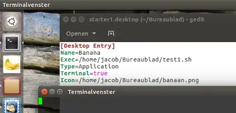

Why it doesn't work like you do
As mentioned in the comment, an application in principle can only be represented by one icon in the launcher at a time. This has always been the case.
What you are referring to is probably that Unity has become "smarter" in determining which of the .desktop files is the best representative for the application's window. Therefore, your script, running a terminal window, will be represented by the gnome-terminal -icon:
Therefore, what worked in the past in your setup, simply creating a launcher, starting your script, doesn't fool Unity anymore, and it picks the existing gnome-terminal launcher to represent your window.

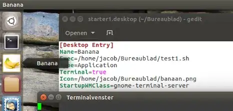

The bad solution
...is to overrule Unity's choice by adding a line to your launcher (for 16.04):
StartupWMClass=gnome-terminal-server
...but then all terminal windows, no matter if they run your script or not, are grouped under this icon.
Furthermore, in general, having multiple .desktop files, calling the same application in their main command is bad, unclean practice.
