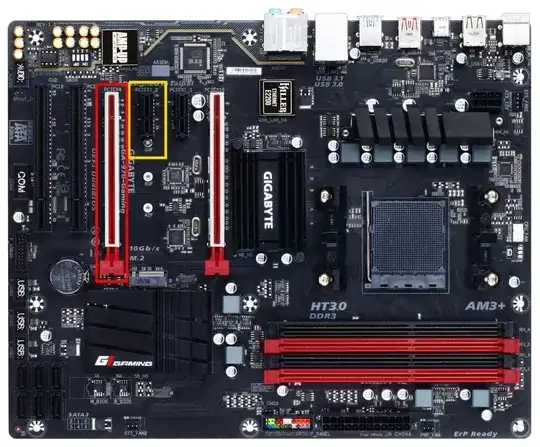

I am trying to build a new machine using the Gigabyte GA-970 G1 Gaming motherboard, together with a TP-Link TL-WDN4800 N900 Wireless Dual Band PCI Express Adapter, which shows up as a Qualcomm Atheros AR93xx Wireless Network Adapter in the output of lspci. On this machine, I have installed Ubuntu 16.04 LTS with the 4.4.0-21-generic kernel.
The issue is that while I can see the SSIDs in the network manager, I cannot connect to any of them.
Note: While suggesting any solutions, particularly those which involve installing firmware drivers from the internet, note that I do not have internet on the afflicted machine. The onboard ethernet controller is incompatible with Ubuntu as well, and the attempts that I have made to fix that are a whole another story (question!). So, please account for that in your solutions. :-)

As I mentioned in the comments, I acquired a brand new PCI NIC, and when I installed it in the slot that the WiFi adapter was installed, I was still not able to connect to the internet. This then definitely pointed to problems with the board, and so I switched the slot on which I was installing the NIC and the WiFi adapter. So it turns out that I had the WiFi adapter installed in the PCIex1 slot (see image -- yellow box), and when I switched either to the PCIex4 slot (see image -- red box) both the adapters worked perfectly.
The question then is, is it just this board, or should I not expect to be able to run a WiFi adapter/NIC on a PCIex1 slot? Thanks for all your help, especially @jeremy31 and @chili555.
