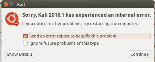

I am in need of a lot of help right now.
Recently I had tried getting Kali Tools and I had downloaded a Kali Tools repositories and now it's not letting me do anything.
I didn't know that by downloading the repositories for Kali Tools would mess up Ubuntu. I'm getting different errors.
Here you will be able to see a picture of the errors to see if you guy/girls can help me.
I have been trying to open Software & Updates but it doesn't work. Everything that comes preinstalled into Ubuntu doesn't open. It only loads then closes. So that's something bad because I don't know another way of deactivating repositories.

There are now a lot of underlying issues with your installation of Ubuntu.
Essentially, you managed to replace all the system configurations and definitions you had with those that Kali Linux provides.
You can see this in your screenshot -- your system has now named itself Kali 2016.1, which is the absolute least of your worries. Due to how Kali Linux operates and what it does, it has replaced a lot of config files with its own versions.
The only way to restore your working Ubuntu installation is to backup any important data from your /home folder and re-install Ubuntu. There is very little you can do to patch what you've done.
In the future, don't import PPAs from dissimilar OSes, unless you know exactly what you're doing and that there's no other way to accomplish what you want.

Open a console (terminal) and type sudo nano /etc/apt/sources.list and remove all entries from Kali. Then run sudo apt update.
To get rid of the error messages run sudo rm /var/crash/*
