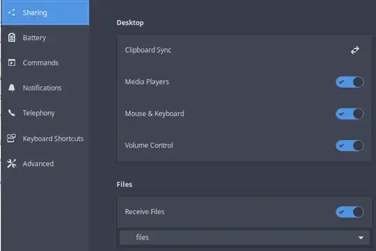

From the "Start Menu" one typically have something like:
Entering “Mobile Settings” I have:
Where I can set custom path for received files, and then also set up scripts for that folder (inotify etc.) One can also set up commands etc.

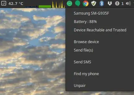

Notifications are sent to desktop (SMS, calls, etc.). I have KDE/GS icon in my head bar:
Which has a decent SMS GUI interface, share files option etc. Clicking the share icon at the end opens a file selector where file(s) to be sent can be selected.
