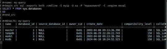

Emacs
If you just need to run queries, then Emacs has SQL-Mode built in. By default, the outputs are as ugly as grabbing outputs from the terminal. However, that link also shows how to make the output look reasonable via either Org Mode or SQL-Mode.
SQL Mode
Org Mode
