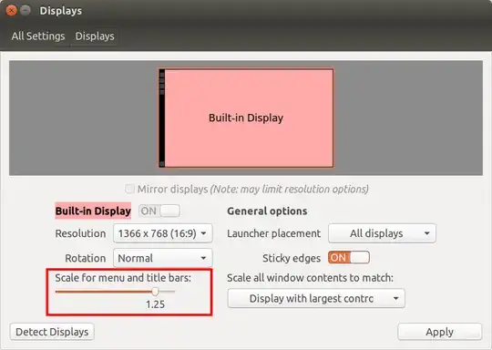

One can also increase scaling factor in System Settings --> Displays --> Scale factor

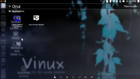

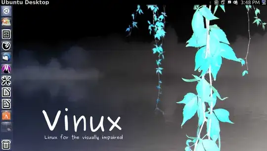

The best option is the Vinux Project.
Vinux is an Ubuntu derived distribution optimized for the needs of blind and partially sighted users. By default Vinux provides two screen readers, Braille support plus an accessible suite of applications.
Features :
  • First of all, its available in 3 different Desktop Environments. (all by default)
    1. Unity
    2. Gnome
    3. Mate Desktop Environment.
  • Includes Orca Screen Reader and magnifier.
  • Includes Speakup : console screen reader
  • Includes Compiz : a magnifier based on 3d technology
  • Wonderful support for Braille displays. You get the best drivers.
Interested to read What Vinux Users Think? Testimonials : http://www.vinuxproject.org/what-vinux-users-think
To Download Vinux 5.0 : http://vinuxproject.org/downloads/

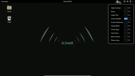

  • Sonar GNU/Linux
    Sonar GNU/Linux aims to be an accessible GNU/Linux distribution to people of all needs. The project's goal is to bring awareness of free accessible software to people that depend on assistive technology. It is based on Manjaro Linux.
    Sonar is designed for people of all kind of disabilities. It helps people with Low motor skills, Visually impaired
    Features :
    • enter image description here Assistive Technology Built-in
    • enter image description here Orca screen reader
    • enter image description here Screen Magnification
    • enter image description here On-screen Keyboard
    • enter image description here OpenDyslexic Font
    • enter image description here eViacam Head and Eye Tracking Software
    For more details, visit http://sonargnulinux.com/

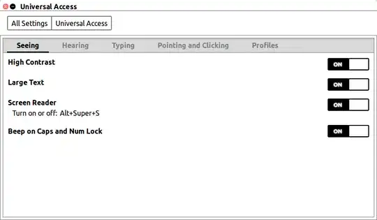

The "Seeing" tab under the "Universal Access" program has settings to help the vision impaired.
Full blindness is going to be difficult with Ubuntu, but it is possible to use it, primarily with the Screen Reader function.
For partial blindness, settings like High Contrast and Large Text can also help in addition to the Screen Reader.
There are more functions and settings in the different tabs in the Universal Access program that can help as well.
Alt+Super+S turns orca on, but sometimes, on weird configuration, it is'nt working, in this case, ctrl+alt+t then sudo apt install orca. If orca crashes, it happens some times, open terminal and type the following command. orca -replace I hope this helps!
