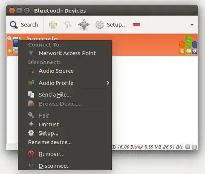

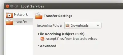

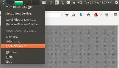

After some time with Bluetooth upload from phone not working on my laptop, I found that installing blueman-applet (sudo apt install blueman) and adding 'trust' for the device and then specifying to accept uploaded files fixed my problem. I don't really know why there are two Bluetooth icons in my taskbar now -- but the blueman-applet seems to provide a lot more options than the standard Gnome/Ubuntu applet.
The extra applet menu:
applet menu
Context menu of the Devices list allows 'trust' of device:

Local Services dialog allows Bluetooth to accept uploaded files:
accept files

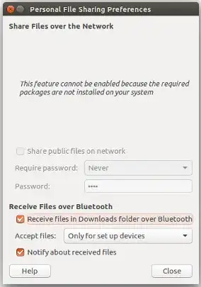

EDIT: further digging shows that there is a 'Personal File Sharing' dialog recommended by Ubuntu that is supposed to support this functionality directly without blueman-applet. But it didn't work for me.
personal file sharing
