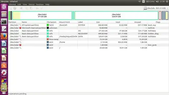

I've run out of space on my root partition and I want to extend it. I've seen another posts of this topic but my lack of knowledge makes it difficult for me to achieve what i want. Here's a screenshot of my GParted Window:

You can't resize the root partition while you're in Ubuntu. You must use the GParted Live CD/USB, and then, according to your picture, shrink sda5 and grow sda9

As stated, you can't resize partitions while you are using them. To resize root partition, boot via Ubuntu LiveUSB/DVD or dedicated GParted Live CD/USB. If you use Ubuntu liveUSB/DVD, open the terminal and type
sudo apt install gparted
Then, open gparted and shrink (top menu - Partition->resize) the partition you don't need to be so big (not SWAP!) and then extend sda9.
Then apply changes and wait for them to finish.
