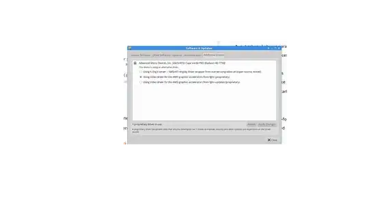

Results of lspci | grep VGA
01:00.0 VGA compatible controller: Advanced Micro Devices, Inc.
[AMD/ATI] Cape Verde PRO [Radeon HD 7750/8740 / R7 250E]
I think I should I have the correct (proprietary) drivers installed.My video drivers settings?
