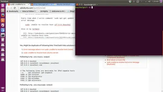

Every time when I write command sudo apt-get update I get following error message.
sudo: unable to resolve host 127.0.0.1kaushal
Also in my terminal I get kaushal@127:~$ as following screenshot.
It was not like that before.
