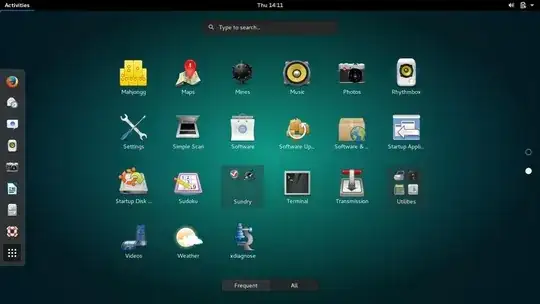

Everything is fine and smoothly. But I want to reduce the icon size in "Show Application" grid.
Middle Part in below Screen enter image description here
How can I do it !!

The themes are now in binary files gresource, you would need to either unpack the gresource file, make your change and put it back together.
mkdir ~/shell-theme and create extractgst.sh inside this directory and paste the following to that file.
#! /bin/sh
workdir="${HOME}/shell-theme" gst="/usr/share/gnome-shell/gnome-shell-theme.gresource" mkdir theme
for r in gresource list $gst; do gresource extract $gst $r >$workdir${r/#/org/gnome/shell/} done
Execute above script you will get all source file from gnome-shell-theme.gresource.
Use your editor and edit gnome-shell.css file.
And fix values as the following(You can choose other values).
.icon-grid {
    spacing: 18px;                       /* was 36px */
    -shell-grid-item-size: 35px;         /* was 70px */
.all-app .icon-grid { -shell-grid-item-size: 59px; /* was 118px */ }
.all-app .overview-icon { icon-size: 48px; /* was 96px */ }
Now you have to build new gnome-shell-theme.gresource
Download gnome-shell-theme.gresource.xml from github and put it into your ~/shell-theme/theme directory
cd ./theme
glib-compile-resources gnome-shell-theme.gresource.xml
Then copy the resulting gnome-shell-theme.gresource file to the /usr/share/gnome-shell directory.
