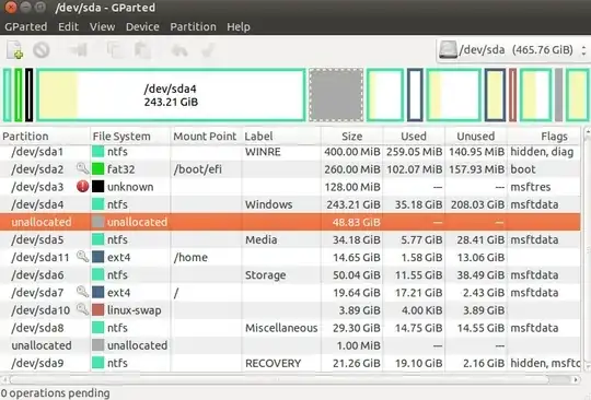

I recently received a notification after the latest updates (Ubuntu 14.04.4) that I am running out of space on my root folder. I performed sudo apt-get cleanbut the space freed doesn't seem to be enough (1.5 GB free). Therefore I am looking to add another 50 GB to my / folder. I have freed 50 GB using my Windows Disk Management which now shows as "unallocated" (below sda4) on my Gparted:
my GParted
Is there any way to integrate this free space with my root folder while I'm online? If not, is/are there (an) alternative(s) to what has been suggested here?

In your case, you will have to shift all the partitions that are located to the left of your root partition to the left, to in the end create a 50 GB space at the left of your root partition. You cannot bridge two partitions if you are asking that.
Mind you that this will take a long time, and may result in data loss if the operation is interrupted.
Please backup this data if possible.
Best of Luck to you!!!
