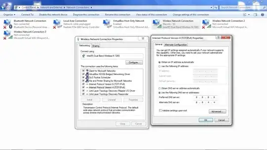

I want to configure the IPv4 settings to have automatic assigning of IP address but manual assigning for DNS. How do I do it?
Please teach me how to do it step by step.
Please take a look at the image to get an idea of what I am asking.
Thank you in advance.
Windows DNS settings example:
