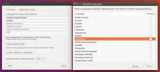

First you need to install Malayalam language packs. To do that, go to System settings --> Language support --> Install / Remove Languages ...
Search for Malayalam and check the related box
Then click on Apply. (NOTE : You need to have a working Internet connection for downloading related packages.)
After installing the language, go to System Settings-->"Text Entry" and click on + and search for related input methods.
And click on Add. After adding , press Super (Win) + Space to switch between installed input methods. You can type in Malayalam when input method is set to Malayalam ( Ml on right top of your screen )
