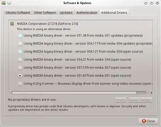

I guess you haven't installed an NVIDIA driver so far. You can easily install them via the Additional Driver tab in Software & Updates.
The dialog might look similar to this:
