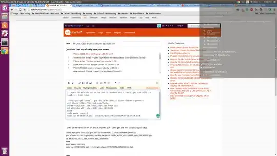

I tried to mt7610u on 16.04 and it worked but I can't get the WiFi to load. It just says "device not managed":
sudo apt-get install git build-essential linux-headers-generic
git clone https://github.com/Myria-de/mt7610u_wifi_sta_v3002_dpo_20130916.git
cd mt7610u_wifi_sta_v3002_dpo_20130916
make
sudo make install
sudo cp RT2870STA.dat  /etc/Wireless/RT2870STA/RT2870STA.dat
