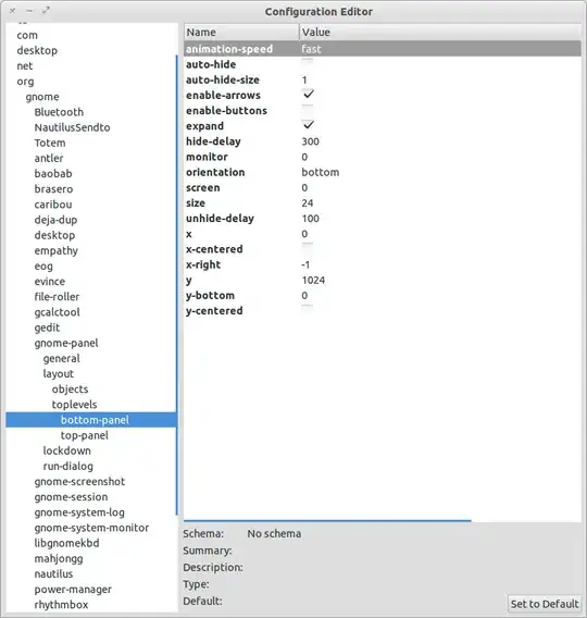

Settings for GNOME Panel are stored in dconf, now, and you can access them using dconf-editor under: /org/gnome/gnome-panel.
Stuff in dconf is stored in a binary format, which is why those options didn't show up in a search.
To run dconf-editor:
Screenshot: dconf-editor
