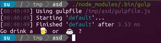

Not strictly related, but here is a screenshot of how it plays with https://www.npmjs.com/package/gulp-emojify, npm package that uses emojis for automation messages:
Ubuntu terminal executing Gulp command, with a waiting message displaying a Beer and a Coffee emoji
(You may have to sudo apt install fonts-emojione)
