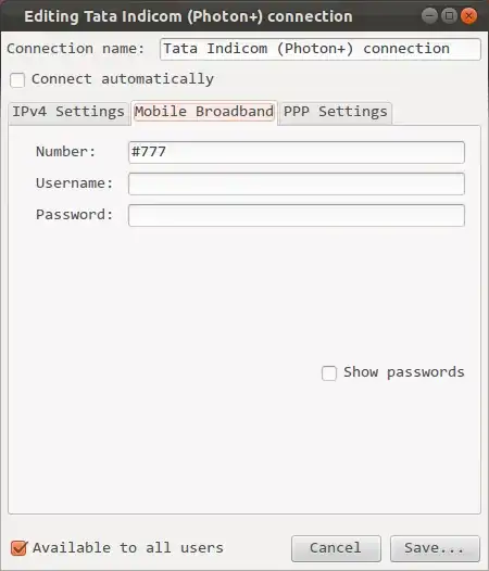

But, the network manager detects the device. I tried setting it up from the network manager. The connection is set up but it doesn't connect to the network. There's no error message or anything(It just says you are not connected to the network)
I've done this on 12.10, 12.04 and 11.10 and I hope it works for you as the OS is able to detect the device.

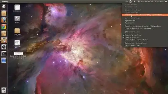

Please Try the following..
I believe this is what ur screen looks like

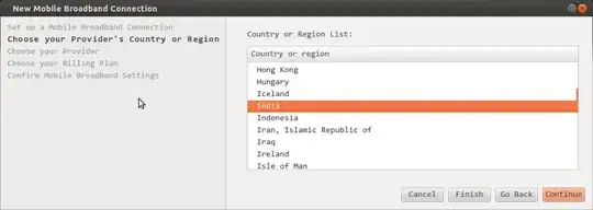

Click on the New Mobile Broadband (CDMA) Connection.. and U'll get this screen

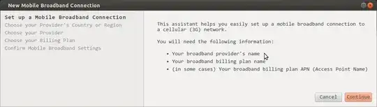

Hit Continue to get this screen

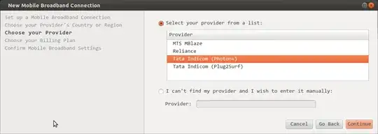

Select Tata Indicom (Photon Plus) and Hit Continue

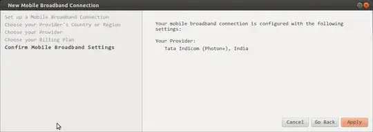

You reach this point now

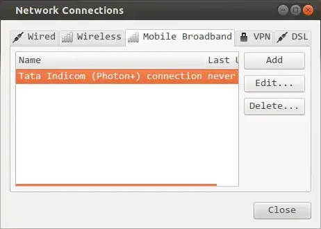

Now ur Network Connection Dialog Box should look something like this. In the same place click on "Edit Connections"
Select Mobile Broadband Tab. Select Tata Indicom (Photon+) and Click on "Edit.."
Select Mobile Broadband Tab Again. U see a screen like this
Type in..
Username: internet
Password: internet
Click On Save. Then Close the window. This should get u connected.
