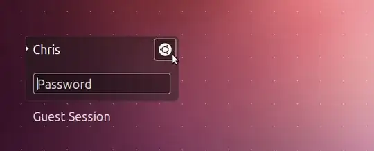

If that finished, logout and back in the login-dialog (most likely lightdm) choose your session type and relogin to a new session - this time using Gnome.

Logoff, then select the Gnome Desktop at the login screen.
