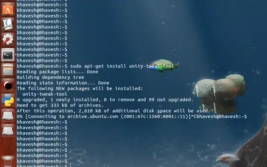

Installation of Unity-tweak-tool is stuck at 0% and showing nothing. I've to press CTRL+C to stop. I've checked internet connection and it is working fine.

            I have encountered the problem ever, the reason is that it use the IPv6 address to access the software repository, but I found the apt-get may can't handle the IPv6 address properly, so you should use the IPv4 address instead.
You can try sudo apt-get -o Acquire::ForceIPv4=true install unity-tweak-tool
