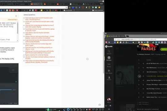

I have a weird problem using Kubuntu 16.04 on my Dell XPS 501X with Nvidia graphics. Upon connecting an external monitor at HDMI, the two monitors work, but if I scroll my mouse to access second monitor the whole thing pans and clones on my external monitor. This is a view of my external screen - which shows the laptop screen too. This is best seen in the video below.
This scene shows on external monitor, and the laptop screen only shows the second (spotify) screen
Here is a link to video demonstrating this - very sory for the noisy fan

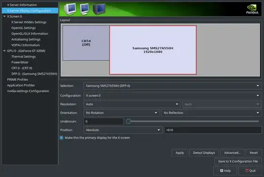

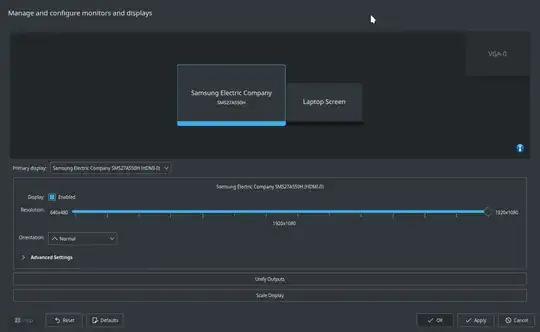

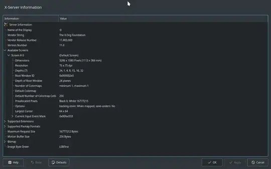

Is there a solution to this problem? I am using 361.42 drivers from Nvidia. The display confg screen, xserver settings and Nvidia config look like this:
Display configuration
Xserver settings show panned display
Nvidia config
