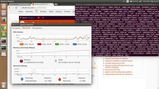

Every time I compile the code, the system gets stuck. To diagnose the problem, I saw memory performance in the system monitor of Ubuntu, and compilation eats the whole RAM. Then it also starts eating swap memory. My laptop has 4 GB RAM. I extended it to 8 GB RAM. I created a swap partition of 12 GB. But once my swap partition utilization reaches 4 GB. system hangs. Why is my whole swap partition is not being used (see below)?

The system may not be hanging, it's just that it's so busy swapping stuff back and forth, it appears as though it hung.
@phihag said in the comments:
Most likely, when swap reaches 4GB this happens to be around the time that some part of the user interface gets swapped out. For instance, that could be the code to handle Ctrl+C, the keyboard layout handler, the code that displays output in the terminal, some data buffer of the terminal, some data buffer of the X server which paints pictures, etc. . Chances are if you wait a couple of hours either your swap is filled up or all of the data and code necessary for the Ctrl+C to be handled at the various layers has finally resulted in killing your Fortran process
