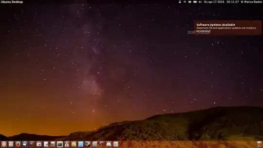

This message is shown sometimes after booting:
This obviously leads me to believe that there is an update available somewhere, but clicking on it does nothing, and I can't find any updates in the Software Updater either. It would at least help if it let me know how to install them.
How/where do I install these updates, and if this is a bug, how do I fix it?

I would recomend to clean your packages and run an update by the terminal. first:
sudo apt-get clean
and than I have a nice code for you- I ran it since 6 years, started an my 12.04 and now at (still) 16.04 LTS and be very happy with it:
sudo apt-get -y update; sudo apt-get -y upgrade; sudo apt-get -y autoremove

The extra and outdated notification messages are a bug. This has been fixed in development and the update will be released for Ubuntu 16.04 soon, probably later this month (June 2016).
Try running sudo apt update && sudo apt dist-upgrade.

As to my experience: After running these commands:
then this command:
sudo apt list --upgradable
i got a list of upgradeable packages, then i ran this command on each of them:
sudo apt-get upgrade XXXX
which XXXX is the package name. Then the problem was solved.
