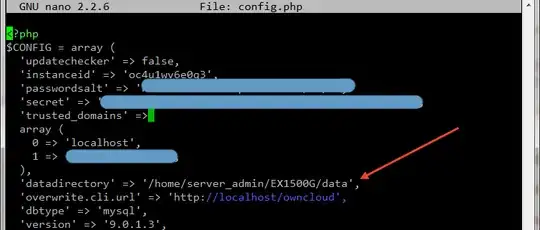

Prerequisites:
  1. Data directory on the Owncloud server : Connect to server via ssh.If you have installed owncloud server to default location (/var/www), then go to the config file to find about the data directory location.
nano /var/www/owncloud/config/config.php
This file will tell you the location of the data directory (the place where all the files are stored.). Like this; Config.php file of owncloud
