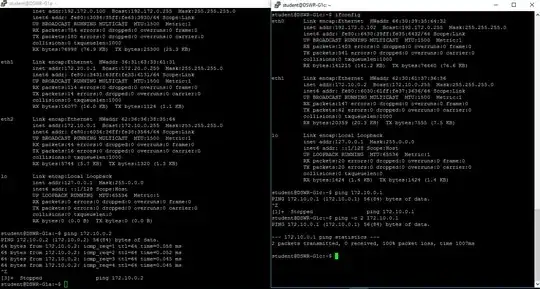

I am working with a virtual machine. I can ping the other machine from my "Router" but not able to ping back from the "client"? Can anyone help me in this regards.

This looks like a firewall is locking the ping.
I supose you are using Ubuntu 12.04.
By default, ubuntu has no firewall configured, but you can try to stop it.
sudo ufw disable
You can try to stop iptables
sudo service iptables stop
It will stop the service. Try if you can conect now. To start it again.
sudo service iptables start
Or maybe can be a virtual machine issue. When I was making an own lab on virtual box from Windows, I couldnt ping from my virtual machines to windows. I didn't fix this issue.
You have to bridge your virtual network card with your real network card.! They must be in bridge mode for this to work.!
