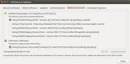

Images
My additional driver tab image: enter image description here
