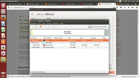

Hey guys, I have this trouble. At first my Lap has Ubuntu and Window. But the grub has crashed and the best way to save it was backup data and reinstall OS.
I chose to install Window7 first, after that was Ubuntu. The mistake happened and i didn't recognize was The volume after shrinked for Ubuntu was LOGICAL. And when then I let Ubuntu chose the place to live automatically so it killed my former Window ~cry~
Anyone have some info about how to gparted this Volume and re-install Window7 from Ubuntu OS ? Give me some instruction or links as possible.
Ok, if that image represents your PC's true situation, then your installed Windows is pretty much gone for good. Irrecoverable. Because you reformatted that partition from ntfs to ext and did overwrite the allocated space with your Ubuntu.
